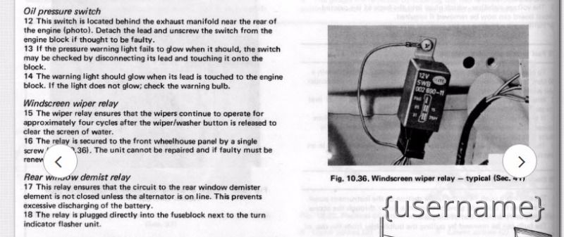

<p>this weekend again another issue arose, we bought the car without a working windshield sprayer! oh well, cant be that hard to figure out right? well im in the process of figuring that for myself. im the worst with electrical so ive determined a few things. first, the motor works, i jerry rigged it to the car battery. the thing spun up and whirred no problem; the second thing is that none of the fuses underneath the dash are blown... except the one i broke by hand LOL</p>

here's a screen capture of the wiper relay
And a link to the Haynes manual and wiring diagram: https://manuals.co/workshop/opel/…nes/5530718/159
i managed to get it figured out, my first guess was the relay too but when the wiper motor works and looks to be wired into the same relay I got a little suspicious.
Tore into the steering stalk and found a wire just hanging loose. Crimped and put back, works just fine.
